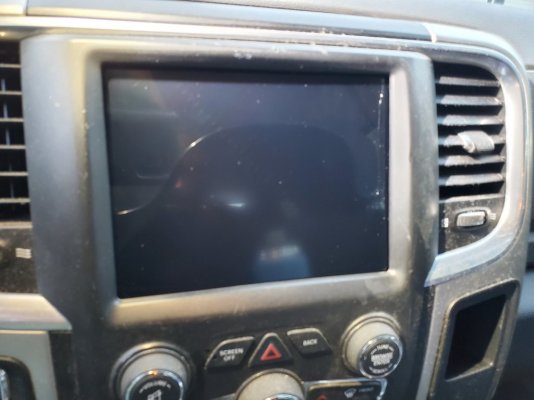

I now have a crack across the lcd screen or the digitizer. Without taking the radio 20221027_174048.jpgapart, is there a way to tell which is cracked? I can run my fingernail over the crack and don't feel anything. Everything is functioning normal expect every few months I get ghost touches in the upper right corner.

I now have a crack across the lcd screen or the digitizer. Without taking the radio View attachment 505468apart, is there a way to tell which is cracked? I can run my fingernail over the crack and don't feel anything. Everything is functioning normal expect every few months I get ghost touches in the upper right corner.
It's not a crack, your screen is delaminating. It can be glued back together (messy and time consuming) or replaced (only less time consuming in your case as it looks like a lot of adhesive has leaked out and will be on the radio).
@RamCares may be able to assist you with a repair/replacement.
