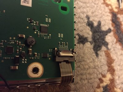

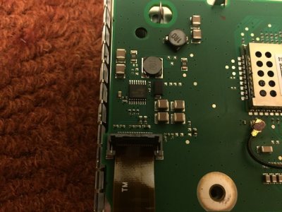

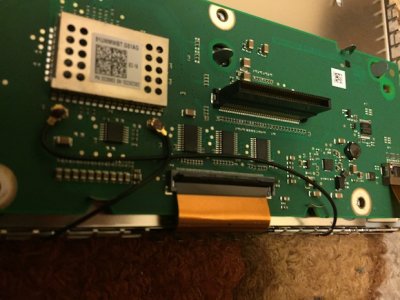

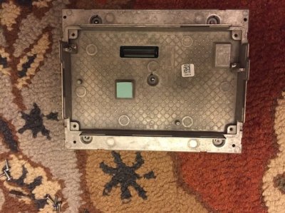

There are 4 screws on the inner corners that are the same size as bracket (T10). Take those out. Lift that center section straight up. The board that it is plugged into *may* come out. If it doesn't, it will still be attached to the back of the screen. Pry it out (again straight up) and you should be staring the first attachment.
There are five screws (you could see 4 of them before, outside corners). They should be T8. Unscrew those and the screen should separate from the cast body. There is another circuit board under it. You will need to pop off the little antenna looking wires from the board. Then you will need to detach the ribbon cables. The the left and center ones are plastic and flip up toward the top. The one on the right you need to flip the metal toward the bottom. Hope this helps.

Worked!! Once I got it separated from the case and the LCD off all I had to do is a little hairdryer heat and it peeled from the LCD like an iPhone screen. Just put it all back together and waiting for my new harness from M2 to arrive early this week and the bezel. Then next change may be adding center console and upper glove box.
Thanks for all the help.
