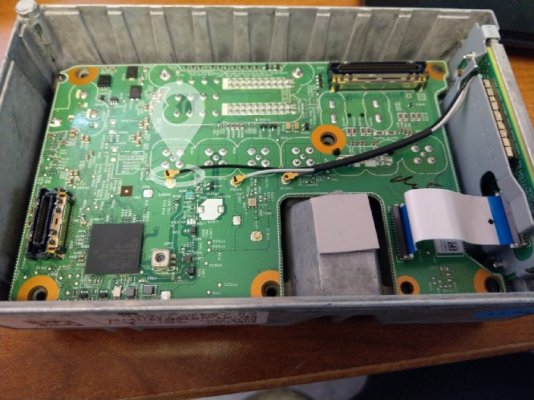

I actually just had mine open to add a heat shield for the screen and decided to see what might happen if I just disconnect the cellular antenna internally. No errors pop up unless you actually try to use the SOS features (which fail). I think I'll leave it like this for extra insurance.
Thanks for making me think about it. I'll post pictures of what to disconnect when I have it out again to replace the thermal pads...b1e586cb2673f01ff14efa798a815441.jpg

Very curious to see how it goes with it disconnected for awhile, thanks for being the guinea pig here, my only concern is that im still under warranty and have 8yr maxcare plan i dont want to void. Just got done reading your posts about delaminating screens and knew you had the knowledge about these head units. Just had a sub installed, sounds amazing, last thing i want is for Uconnect to screw up the sound again or worse brick the radio with a **** update

The good thing is there are no tamper seals and these radios are very easy to open.
Another forum member sold me a UAQ for parts so I feel obligated to pay it forward by seeing what all can be fixed (and I like to tinker). I'll post an update after a week or so but so far, it appears that antenna being disconnected is completely transparent unless you actually use UConnect features...
Here is the antenna to disconnect from the inside...
I wrapped it in electrical tape so it wouldn't touch anything I didn't want it to. I'll likely reconnect it before doing any manual firmware updates just in case. Drove for hours today without error...

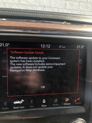

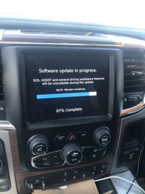

Mine just updated over the air - it did give me the option to schedule the update but I stupidly just did it when the message came up. Some weird stuff just after the update - my heated seats and steering wheel would turn off very quickly (seems to be ok now) - and hours later I came out to the truck and the lights were on (they are always on auto and that never happened in the year+ I have had the truck) - I don't even know if these things are connected to the update .... 2019 Ram 1500 Classic
was hoping it would fix Android Auto - where it only shows the first song I play, then stays on that screen while any other songs play....
