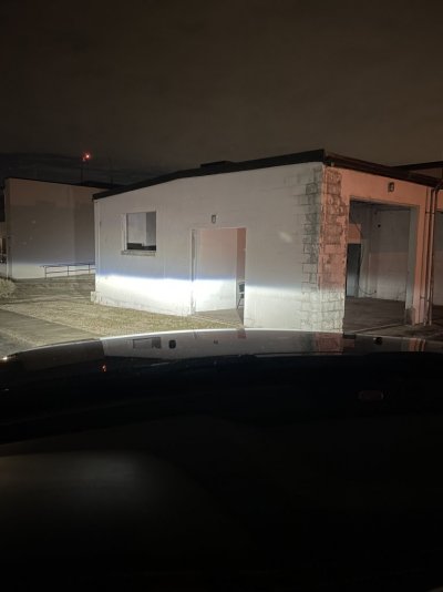

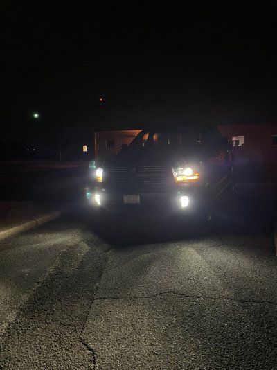

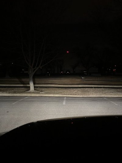

Got my Underground Lighting HID kit yesterday in 6000k. They made a huge difference! The install was straight forward. Initially the lights didn’t come on. But I had read somewhere to flip one of the connections. I did and they fired right up. The only thing that left me a little concerned was the bulbs being a bit loose after install. I remedied that quickly by adding the rubber grommet from the old bulb. Now they are perfectly snug with no wobble while driving. See pics. :waytogo:
HID low
LED high
BA269885-C81D-464A-A4E4-336B7FE6858E.jpegB6DFE4FB-5E5E-407D-B3E8-8F23BAD086B6.jpegBBEA41CD-4CB0-44C5-9CEB-4CB412EFE237.jpeg
