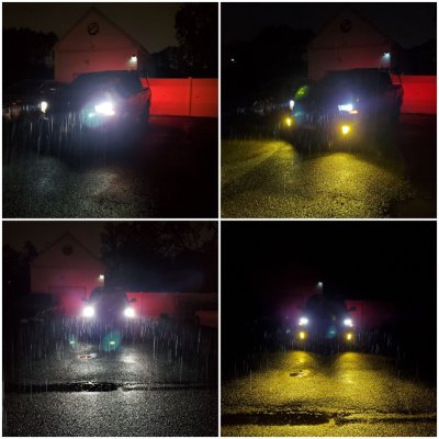

All I can say is wow...I adjusted them and drove around for about an hour. Didn't get flashed once. The only bad thing is I wish I had gotten them sooner. Im not sure how the picture's show the light but its literally a night and day difference.20200506_212314.jpg 20200506_212227.jpg 20200506_205301.jpg

:D I've never had yellow fogs before. I live close to the ocean and its always foggy. Figured I'd give them a go.
I had 3000K HID's in the fogs in my '08 Ram, they work awesome in the snow and rain we have in Fargo.
