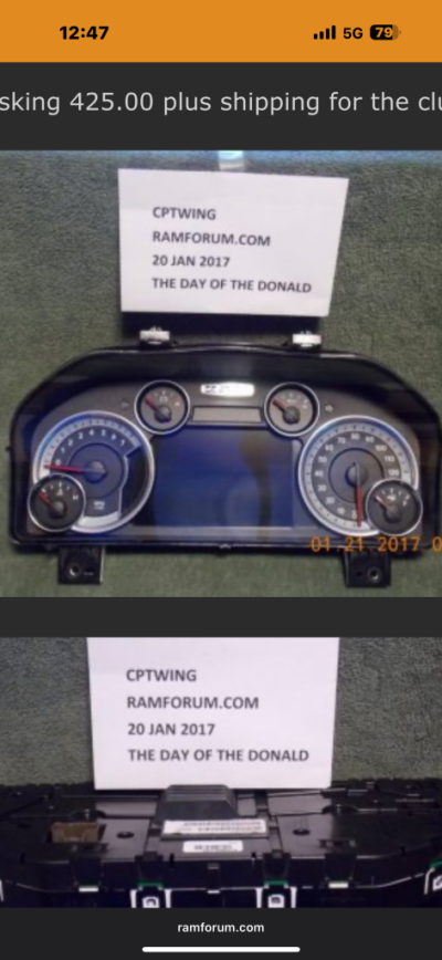

Darn, you may have your answer then. However, look up "cluster flicker" using the search on forum. I think someone posted about repairing the cluster internally not too long ago.This is what I have. It’s flickered ever since I’ve had it. Bought it with 85,000m. Has 114 now. Code just showed up.
IPC?UO155 turned out to be false signal from power steering. Bad IPC.
