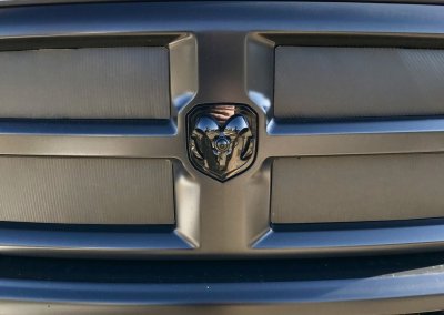

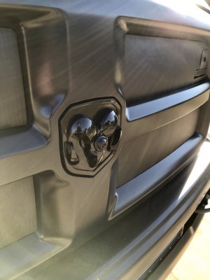

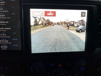

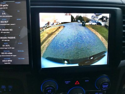

Got my front camera up and running yesterday using m2mods harness and Alfaobd.
It took over 24 hours for it to finally show up on my screen. I also, after to years figured out that you can drag/drop/change icons on the menu bar on the 8.4.
