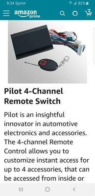

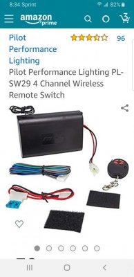

Nope......get a remote operated relay and sync remote to homelink.
I ran that setup for 8-10 months waaaay b4 obd came out. Works great!!

The relay there is nothing to do to it. You use the remote and go thru the process in owners manual of holding the appropriate button down on the remote AND the homelink.
They are set so homelink is push button 1 once is on, push again its off. The relay is really kinda cool and works well, I just needed more switchs so swapped to 4th gen Ram aftermarket auxiliary switchs
