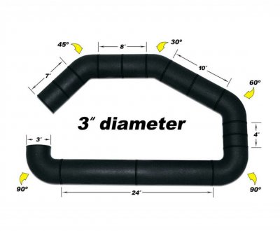

Airaid makes a universal pipe for 100. Might be worth it.
The U bend might be a good route, but I'd be worried about the weight of the pipe over the engine without something to prop it up to keep it from hitting the engine.

Looking at that diagram, I think you could definitely make it work. You'll of course need to post a DIY with pictures. You are coming closer to the cost of the ready to go K&N part, but this could be a nice option...

...and I think you could ditch the over the manifold option I mentioned earlier and use this to mimic the shape of the K&N.
