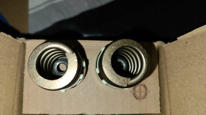

Parts arrived.
Pretty cool valve stem seals. Looks like the inner valve spring is married to them.
When I get it apart, will have to see how many of those plastic surrounds are busted up.
Seems like it could complicate my valve spring compressor plan. Will see this weekend.
