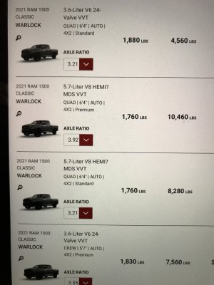

Tow guide is different from 8 speed transmission and rfe, that is the 20021 tow guide 8 speed. I posted one from the rfe years.

I have the RFE with 3.55 gears, never knew you could get it with 3.21's - what's interesting is on this chart
https://www.ramtruck.ca/en_dir/pdf/ld/LD_TowingDetails.pdf
The top half of the chart does show a combination of 5.7 and 3.21, but the bottom half of the chart doesn't show 3.21 at all. 4th gear on a RFE is 1:1 so with 3.21 gears and 265/70R17 tires the engine RPM at 55mph, 4th gear is about 1900. Pretty sure if I was pulling anything larger than a grilled cheese sandwich behind a 5.7/RFE/3.21 truck I'd just lock out 5th and 6th the whole time.
