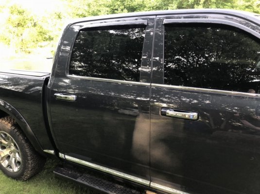

I took mine off on a hot day after sitting in the sun. 778d4d89d7741ff63da4f42cae0e6f0b.jpg
