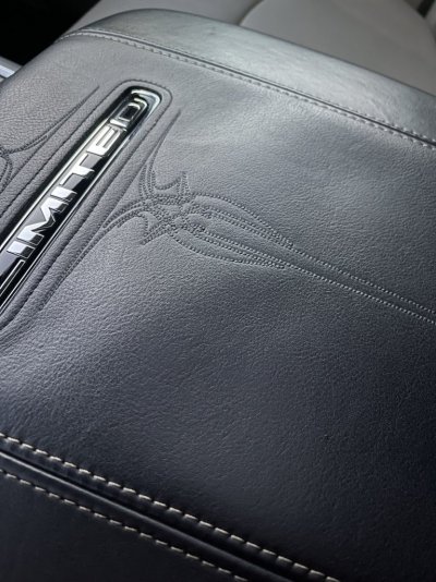

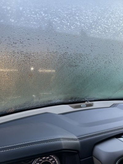

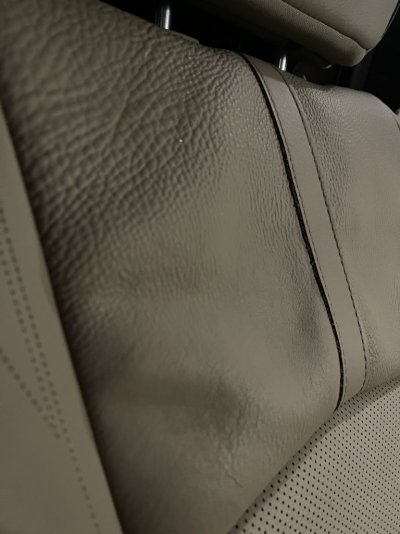

Came home today and wondered why my windshield was wet....it hadn't rained all day. Then I realized it was wet on the inside. Drove it 2 days ago and it was fine. It's been windy and rainy here for a week. Checked sunroof drains....all clear water moves freely through them. When I opened the sunroof to access I heard a couple of pops now when closed the sunroof won't fully sit flush in the rear. Truck was parked on an incline hood facing uphill. Headliner sagging and wet, both visors wet, center console trim starting to seperate and bubble, rear seat covers damaged, carpet soaked. I don't think 3rd bake light leak would wick that much water to the front of the truck. Is the xm antenna my only other option? It has all original glass so possibility of a windshield seal leaking? Just trying to figure out where to go from here. I have an appointment 1/3 for warranty clear coat repair and no dealer within 150 miles has availability to look at it before. It's a 2018 RAM 2500 Limited still under base warranty. Just trying to minimize the damage. Have a feeling this isn't going to end well.

The fact that it looks like water got on the seats and center console leads me to sunroof. Antenna sits to far forward unless you were parked uphill

I was parked facing uphill. Center console wet, all carpeting wet, headliner front to back wet. Picture of the leather seats is the rear.

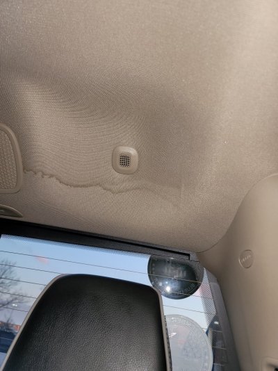

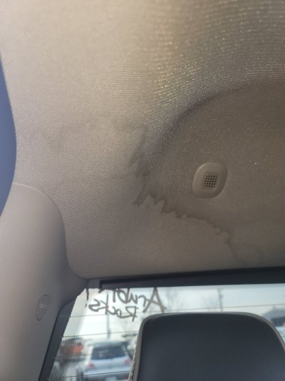

Could be antenna and could be 3rd light.. I saw condensation on my window and blew it off and your pictures reminded me...had photo..but these are my photos 2020 1500 found on 1/25/2022. Also someone said third light for problem like yours since its traveling down the path of headliner. Totally sucks!!

Im in same boat no help from dealer with rental. I bring my truck in too for the water leak on Feb 3 2022. I feel carpets damp, rear seat cup holder inside was moist, headliner, speakers. We'll see what they do with me at dealer. Heres my photos so you can also compare. I have a 2020 Ram Laramie.

Just an update on my 2020 ram with water leakage. Took to dealer today and water leak was present because of rain so they said it was coming through window and 3rd light. So base on what they saw they are replacing headliner, speakers, mics, 3rd light, window and the carpet.
