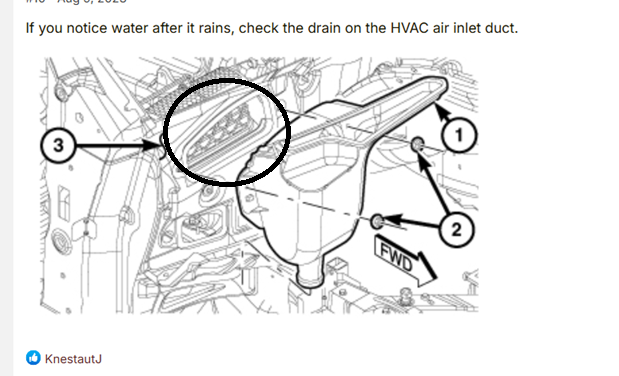

I had a similar mystery leak in the wife's Durango. the water was filling the passenger side floorboards and filling the battery compartment under the seat. It was clean rainwater, and only happenend when it was raining. (Which, here in the PNW, is pretty much every single day.
If frustrated me for about a month before I stripped out the seats and carpet, and lay on my back staring up under the dash with a flashlight, while it was raining. I even had to remove the cabin air filter and blower before I found where the water was coming in.
It ended up being an air intake gasket for the HVAC, in the engine compartment, against the firewall. I had to take the hood off and take out all of the plastic peices below the windshield wipers to get access.
The rain was getting into the HVAC box, and dripping down into the blower motor. A few months after I fixed this leak, I also had to replace the blower motor because the rainwater had rusted the bearings.
the gasket for #3 in this diagram was damaged. I replaced it with RTV and the problem never returned:
