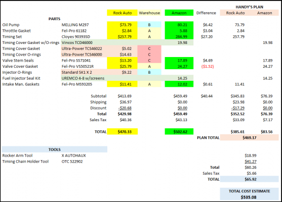

Okay,
Here is my first attempt at a parts list.

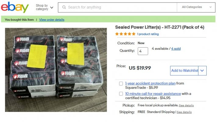

Just added a set of new lifters to my parts list. Power Seal (formerly Federal-Mogul) is known for quality lifters. And at $19.99 for a 4-pack, I snagged all four packs.

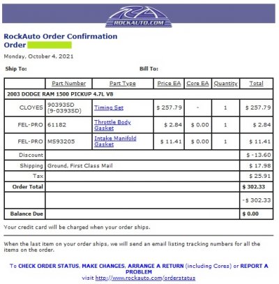

I decided not to get a new oil pump. Changing it would mean pulling the oil pan to remove the pickup tube. I was only going to replace the oil pump because I thought it would be easy to do with the timing components removed. But since the pan must be dropped too, it's not worth it. I still have great oil pressure and these pumps last a long time if not clogged with sludge or metal shavings.
Here's my Rock Auto invoice.

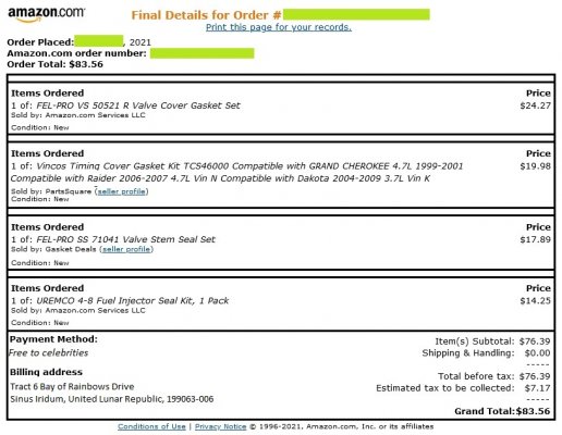

For the record, here's my Amazon order:
