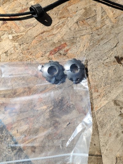

Alrite guys here's some pics tell Me what you think went wrong. Looks like bad casting to me. I've never seen spiders snap in half. I've seen them eat themselves. Oil was good no foreign objects got in to it.

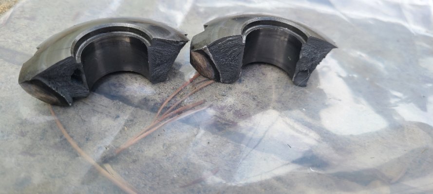

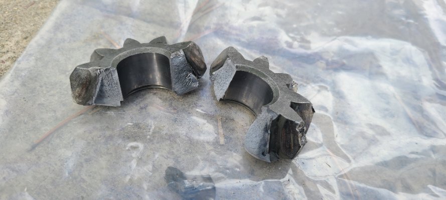

This macroview appears most likely suspect. I didn't seen unusual tooth surface wear or galling indicative of overheating / over differentiating (tire spinning), nor wear on the bearing bore. If it were overloaded by shock, one would also expect to see shock impact on the tooth profile. I didn't see any.
A microscopic examination of the fractures would be useful to see if porosity is present, or contaminant inclusions, that exceed the ASTM limits for the material.

Yeah it was not spinning excessively or anything like that, no shock load I would have definately noticed that. I don't do drag launches or anything like that usually rolling before I hammer the throttle. It's going to get a trutrac no more spiders and friction modifires to worry about.

Those are fatigue cracks. My guess something not correct in the hardening and cracks started at machining marks which are a stress riser.
