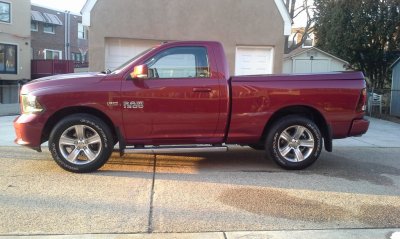

there it is.... my every day hot rod.. no mods.. every thing stock... ill time the mile markers this saturday and fill everyone in

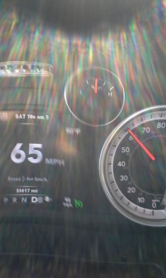

OK, here we go.... first off i wrote it up opposite of what is happening... cruise set at 60 mph and speedo reading 57 mph as per picture.. cruise control set at 65 speedo reading about 61-62 mph.... the digita speed is right.. i timed the mile markers on the highway at digital setting of 60 mph and went 1 mile in 60 seconds... so, the dial speedo is the one that is off... any suggestions on what to do (if anything)
sorry for the blurred pictures

Leave the digital speedo function up and completely ignore the analog speedo... I haven't looked at the analog speedo since my first truck with the digital in the center. Where the analog is positioned in the cluster, it's not really the most convenient to look at anyway.
