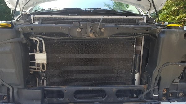

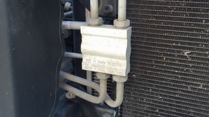

On the 1500s with the 65 it's located on the passengers side of the trans cooler/AC condenser. Looks like a block with 2 lines going in and out...

did you get underneath, did it have that bypass? What that valve does is stop fluid from going into cooler so it will get warm, but when it clogs you can see that is a bad deal. I see the kit/part is 99 bucks, so if you have it I think I can at least get that for hundred bucks.

It has that block thing yes, and it looks like it’s leaking trans fluid too.

get it off man, I bet that is the issue. Don't replace it, use the bypass one. You will never have an issue there again.

Oh i’m DEFINITELY doing the bypass, no doubt about that one. I’m thinking about doing a 160° Tstat on the engine too, to make sure it’s extra cold.

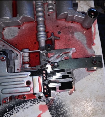

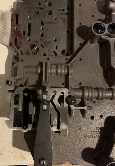

I forgot to post these yesterday when i did the work too. 829712aef5ecd07266994f9a2b5fdd0a.jpg
The bottom one is the vb out of the truck originally, and the top one is the 545RFE VB that caused the truck to have so many issues. The TRS plate is clearly different. Surprised that the fluid is as red as it was on the top picture since it was having so many issues.
