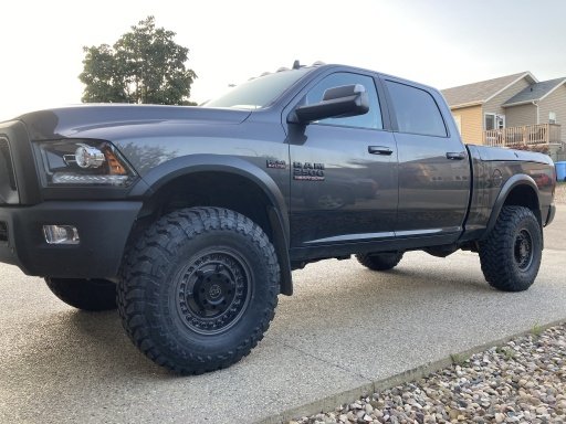

I stole this image from a member on the forum who is running the setup I'm considering and I love the look. 113483.jpg

I like the look of those wheels too, however i do not like the width/offset options for the ones that bolt up to our trucks.

If you do a full on tall lift with bumpstop drops it would help with clearance, but otherwise you will just have to trim a bit at the back side of the front fenders (pinch weld area) for 37’s to clear. A +25 offset (give or take) would put you in a much better position though.

They have that wheel in +12. I have 37x13.5 Toyo MT tires on a +18 wheel and it required a lot of trimming. If your willing to trim and cut a +6 would probably work. Guys are running 37s on stock wheels and trimming to fit.

Yea the stock wheels offer the most clearance to the fender, but 37’s will rub on the radius arm and sway bar (although dosnt really cause any issue).

Trimming with 37s even on Power Wagons? If I understand correctly, which maybe I don't, at +18 offset or the factory wheel, the Power Wagon's lift is enough to clear without trimming. If I have to trim for 37s regardless, I might as well get the wheel I want and start cutting.
