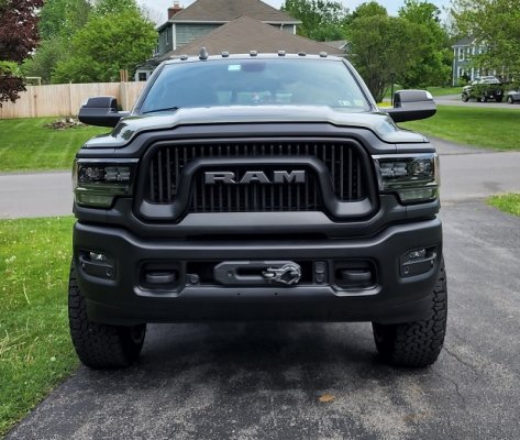

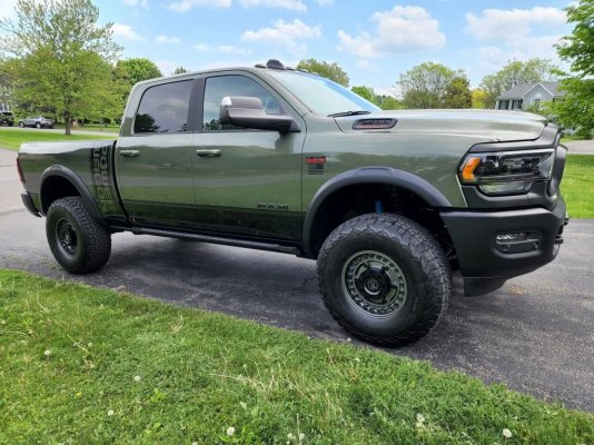

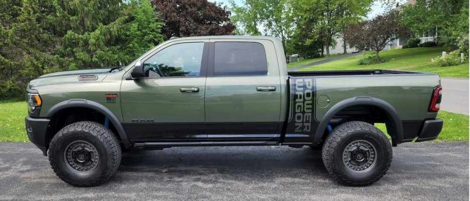

Sorry, I had my Tinder Filter on. Enhance... Enhance...
