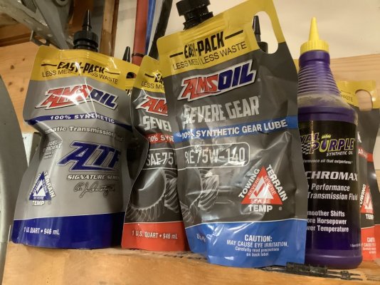

I am willing to bet I thrash my 8 hp70 as bad as any other FI ( blower) image.jpghemi and Amsoil’s tranny oil is just fine at 5 k on the change.But that said how about some other real world tests. Still use royal on my Z06 because it hasn’t failed me either.
