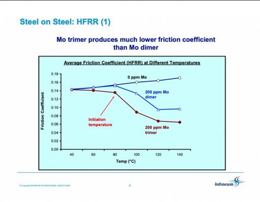

EP additives plate, and that plate is what is stopping the side pressure. It is no joke, the white paper is clear, friction whcih no doubt what hemi tick is goes away with EP additives. Redline is the highest moly oil we've seen.
We will need a new name for bandaid?
Coefficient of friction with high moly at temp.. that is no joke
Notice cam wear is going even lower, and add hemi tick and 500ppm moly, I'd wager the wear level will be way lower then anything on this graph..
