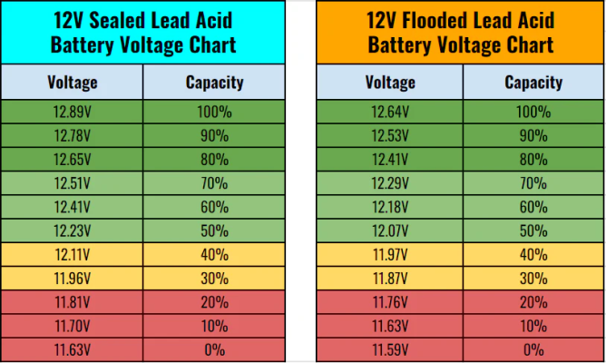

A fully charged 12 volt battery should read 12.7+ volts on a voltmeter. At 12.0 volts it is at 50% discharge. Just the way 12v batteries have always worked. My older Ram V8 trucks struggle to start on 12.0 level of battery charge.

Hi 3 Ram Jake. Can you please clarify the part about your 12 volt battery hovering around 12 volts - and that being 50% discharged?? A 12 volt battery should start the truck - normally when it's at 12 volts. Thanks.
There's 6 cells in the average automotive battery John and each cell should put out between 2.1 and 2.2 volts each when fully charged.At 12 volts the battery is down to a little under a 50% charge
Outstanding!! Never really looked into that ... I thought a 12v battery reading 12v would be a good thing!! Thanks for the explanation and charts!
