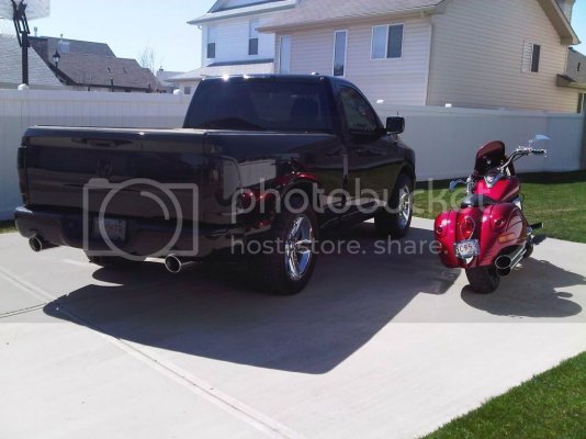

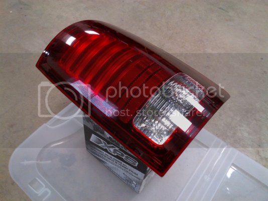

Well the LED's had a few scuff marks on them when I went to check them out in person.
So I low balled him a $200 offer and he snapped it up without question, (original asking price was $300)
I wasn't really all that concerned because I'm having them tinted, wet sand, cleared and polished.
My bud Brad (MGRAM)
already did his wife's 14' Sport tails (3 coats)
so dropped the new tails off at his garage just minutes after I bought the new LED tails
I'll probably stop at 2 coats on mine.
Brad's Ram with 2 coats
37438d1412266215-blackout_edition_13_projector_upgrade-imageuploadedbytapatalk1412266215.470953.jpg

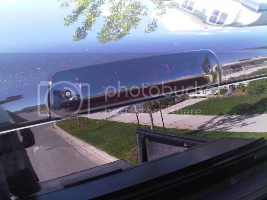

I used to run GTS covers and they were a little too dark
I did my 3rd brake light and mirror puddle lamps with VHT four years ago
My 4.5 y/o 10' is looking more like a new 14' now with heads/tails and wheels :D

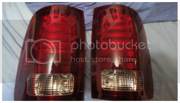

Wet Sanded 3000 grit then polished smooth
got rid of all the scuff marks and knocked down the sharp ridges around the perimeter
First light coat of VHT
One more coat looked just right
Three Layers of SprayMax 2K professional clear coat
They'll cure for another week before final wet sand and polish,
Harness/Adapters on the way soon.

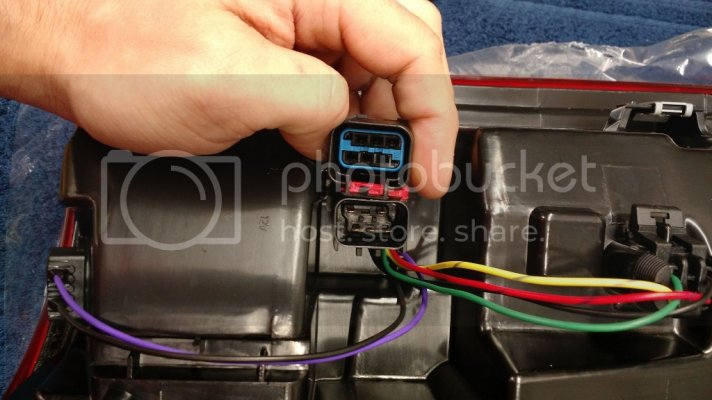

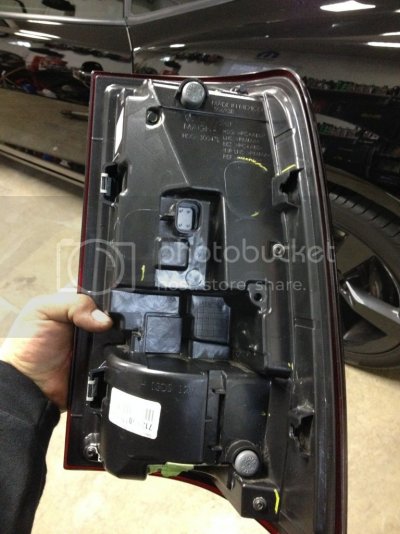

**Be Careful when purchasing used OEM LED take offs!**
Some new truck owners that have Rams with factory LED tails
are removing them in favor of Recons (come in red/smoke/chrome)
BUT they are required to transfer the rear wire harness over from the OEM Lamps.
The ones I got were useless to me because of this,
The harness part of the light does not appear to have its own Mopar part number you can get from your dealer.
The parts you NEED:
The lights as I bought them : no harness, no connectors, no reverse light socket....useless
I was very lucky that a Forum Brother had a spare set to send me,
all he wanted was for me to cover the shipping. :favorites13:
