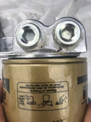

8B4CAA1E-16FA-432C-94DA-8FAE4D98E5E3.jpeg Well to say the least I’m frustrated. I noticed I’ve acquired a small oil drip. Does not look like it’s coming from the fittings. It looks like it’s coming from the filter seal. I tried changing the filter and still leaks. The frame has oil mist on it as well so it’s spraying ever so slightly. I noticed a few drops on my driveway. Looks like I may be removing this filter relocation kit for the time being till I figure out what I want to do. May try a different remote mount bracket in the larger filter size and run some new hoses and fittings down the road. Didn’t notice this till about 300 miles after install. I’m at 500 miles now on the kit. Notice the oil on the tow hook bracket

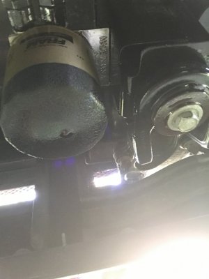

0373CFE1-9F85-40B9-B2DE-E01AE3E5B164.jpeg 6FF026E9-BAC9-4665-913F-F9ED1006A10C.jpeg Figured out my oil drip... the threads are not cut straight on the filter mount... filter sits crooked. Just a tad bit but enough to leak I guess. Swapped with a new mount and of course since I’m doing that I upgraded to the xg8A filter for added capacity and turned sideways with a slight angle for ease of draining.
