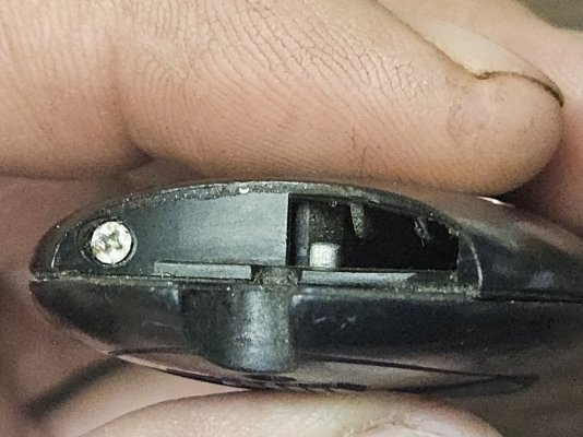

Not sure how your fob comes apart, but mine has a little screw in it. When you remove the key, it's underneath that.
Just look to make sure, so you don't go prying it and breaking something. I think some fobs have the screw like mine and some do not.
When my fob acted up like that, you could just brush your finger over the buttons, with NO pressure, and it would lock and unlock the truck.
