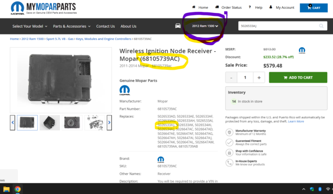

According to my search on MyMoparParts:
The most recent revision for your 2012 Ram 1500 (circled in blue) is 68105739AC
It replaces all of the earlier revisions of this part, including 5026533aj (circled in yellow, bottom).
So, basically this part#, or any of the parts under "Replaces", should work.
The remote start vs no remote start thing shouldn't be relevant, as remote start is a programming function in the TIPM (2009-2012) or BCM (2013+). But, it DOES show a different part# for the remote start version. 68105738AF is the one that shows up as fitting "remote start". It has it's own list of "Replaces" superseded part numbers:
