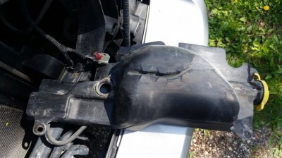

I finally changed mine today. If I knew it was that easy I would have done it last fall when it came on. It took less than 15 minutes. Just take the grill off and there is 2 bolts and 2 tabs holding the washer fluid reservoir on. The sensor is on the back side of that. Just pop up the red lock on the plug, squeeze the tab and pull it off. The sensor just presses in the tank. Wiggle and pull and it comes right out. t's easy and cheap enough that I will still use the good fluid in the winter, and maybe alternate the cheap stuff in the summer.
