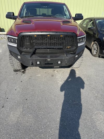

It’s running great. I can feel the increase in power. It’s not like the truck is hoping up on the rear tires, but she definitely has more get up and go. I haven’t pushed her just yet, I’m going to wait till after the break in period before I give her a workout. I’m not regretting this swap at all. Plus it does have a very nice tone to the exhaust which makes my inner kid giggle every time I hear it. I plan on building the motor even more in the future but for right now I’m happy with where it is at.
