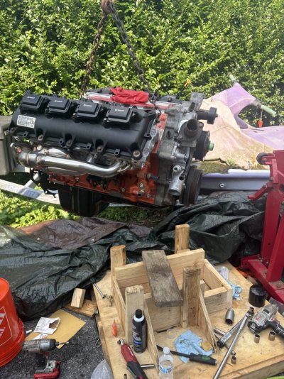

This is it before I put it in. I did get shorty headers to put on it. Eventually I want to throw on the long tubes but unfortunately they weren’t in the budget. I’m also running the stock intake manifold from the 5.7. I will build on to it more in the future but the whole goal right now is just to get my girl running again.

Good pic, thanks! What are you doing for a tune?
I got an HP tuner through mmx along with a tuning agreement. I just make a back of file of the trucks original tune and sent it over to their tuner and he made a tune for the pcm and sent it back to me. I have the tune ready on the HP app ready to go into the truck

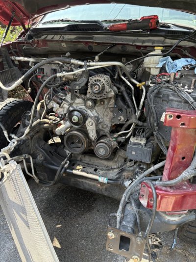

You did some SERIOUS removal of front end components. but made it nice and easy to get at everything. I like that. :smoke2:
I have been checking over everything as I go triple checking torque specs and all. I got most of it done over the weekend but just had to do the accessories. Also who ever designed the flange location for the exhaust is a sob.

I like that, leaving the hood on. Always create more damage taking it off. Removing the front end is the best way to go. Good luck.
Removing the front end made a huge difference, though I was cussing the fact I put one of those bambi basher bumpers on the front. It also made mating the engine and trans together a lot easier. I would have pulled the trans with the motor, but I was doing this myself so I wasn’t comfortable about getting them back in by myself. I left the hood on not only to keep it from getting damaged but also the rain here as been terrible so I kept it on to keep everything undercover and somewhat dry

I got her started today and what a feeling that was to hear it come to life. So I figured I might encounter some things and I did. My harmonic balancer is bad which I was not aware of until I looked at the motor to make sure everything was turning and saw it wobbling. I have a new one that is going to be here first thing in the morning. Also my headers have a slight leak in them which I’m pretty sure I know exactly which head bolt it is, but other than those 2 things, the motor is healthy. Once I get those taken care of I just need to reassemble the front end and enjoy the truck. I will post up a clip of her running once I get those 2 issues fixed the front end reassembled which should be tomorrow
