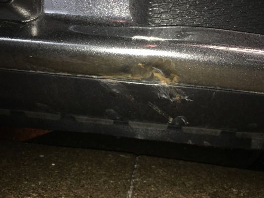

Here's what I managed to do:
Hard to tell, but you can see how the bumper is pushed up a 1/4 of an inch
