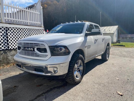

I've searched everywhere to get answers to this but im having no luck and hope one of you all can help me.
I'm looking to do a HD front end swap on my 2016 1500. I've seen other people do it and love the 2500 look. SO what exactly would i need to do this? I know I need a bumper, grille, hood, and bumper brackets. Are the fenders the same on the 2? Any help would be appreciated!
(Inserted pic of my ram)

Northspec Built manufactures bumper conversion brackets to run a 2500 bumper on a 1500! All that is required for the conversion is the 2500 bumper, 1500 Rebel / Warlock / 2500 headlight fillers, and the 2009 - 12 Ram 1500 grille!
