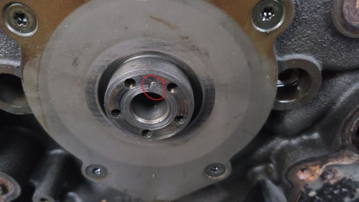

2009 Ram 1500 5.7 Cam Pin Sheared Off
jws123
May 16, 2018
3,217
4,383
nj
I just picked up a cheap 2009 Ram 1500 5.7 170k I was told the camshaft pin for the gear shared off sure enough it did. I assume someone installed a cam at some point and didn't tighten bolt I don't see any other major engine damage with the borescope in cylinders. I am sure it has a few bent valves ect is the pin part of the cam or can I drill it out and replace it? If so anyone know the part number or where I can get one?

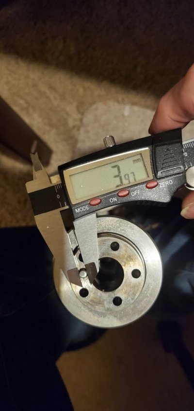

I still have my oem cam I pulled with the pin still in it. If you haven't found o e yet, I can pull this pin and its all yours. Measure it, use it, melt it down for a premium reload, it's all yours. It'll take me a couple hours but them I can break loose and go check out what's there.
Heck with it, my current task s.u.c.ks, I'll go grab it now and send at least some photos.

Glad you found a pin, it didn't feel like this one was coming out in one piece. I even tried a little heat on it.
But there are the dimensions of an oe pin, you can verify your order.

Thanks that's very helpful looks like the pin I ordered is very close

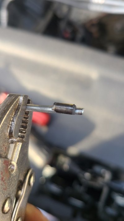

Somehow got the old pin out :D drilled and tapped it little heat and it came right out although i drilled a hair to far waiting for new one to come hope it fits.

IME, almost all cam pins are press fit. Pull cam and see if the hole is thru or blind. If blind, you can A: have a bud with a MIG/TIG weld an extension on the pin and pull it out or B: back drill the blind hole an punch it out. Apply heat sparingly! Good luck.
