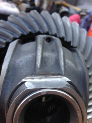

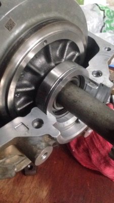

I've got a few pictures of the progress of it. Even with a slide hammer and rigged up puller.... never could get the bearings loose on the driver side so I got brave with a grinder and a flap wheel until I cut it through enough for the inner race to crack through and was able to pop off. Passenger side I left on because they do t give you enough clearance for the rod to come out of the spider gears so that you can get that bearing off. So I threw on the new bearing cup and use the micrometer and Everton g seemed to match up to Timkens bearing specs.
