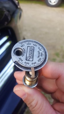

i just did my plugs this past weekend. my truck is a 14 with the 100k mile iridium. im at 74k miles now. i should have checked them a while ago. every single plug i pulled was gapped at .038. should be .043. they were all dirty too! i agree, it was a pain in the behind. not hard work. just hard on the body. i had to stand in my engine bay to get the drivers side rear 6. 4" lift didnt help reach from a ladder.
it was a struggle out in high humidity and 85 to 95 degree temps. but im glad i did it. i dont notice too much difference. maybe a little smoother and more responsive at light throttle. i was seeing 17.2mpg on evic last few tanks..i will watch and see if anything changes. i like the idea of new coil packs. kust not in the budget right now.
i highly recommend at the very least checking your plugs. the front passenger sides are super easy to get to. dony assume the dealer/factory did stuff right. same as assuming plugs are correctly gapped out of the box. mine were all off

You sure you're reading your gapping tool right,that looks like a hell'va sized 0.038" gap going by the pic you posted
