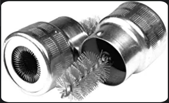

As others have suggested, this sounds like a typical battery or ground fault issue.
The battery being the highest suspect and easiest to troubleshoot, do yourself a big favour and start there. The battery is either brand new and just installed or used. Four hours, 4 days, or 4 months, still used. :cool:
Unless the battery terminals and clamps have been cleaned & serviced within the last few months, that's step 1.
And unless you did work yourself or watched the work completed, or can easily see they're shiny clean & greased, they require cleaning.
Buy a post/clamp cleaner like the one below, they're very inexpensive and you should be using it at least twice per year. Buy a tiny tube of dielectric grease. The smallest tube will last years unless your friends start using it everywhere.
Step 1
Remove both +/- battery clamps, clean posts, and clamps to remove all oxidation or corrosion.
Step 2
Apply a very thin coating of dielectric grease to all contact surfaces, clamps & posts.
Step 3
Reassemble clamps onto posts and tighten them snugly with a wrench.
Step 4
Measure the battery voltage without the truck running. It should be about 12.5 to 12.8 VDC +/-.
Step 5
Measure the voltage again while an assistant sits in the driver's seat and maintains the engine rpm between 1500 & 1800 rpm. The voltage should now be about 14.5 to 14.8 VDC +/-.
These steps will confirm if your battery is functional for short-term use anyway. And we've confirmed that the alternator is supplying a sufficient voltage for the electronics and to charge the battery.
Step 1
Step 2
Step 3
Step 4
Step 5
And, View attachment 516482to Ram Forum. :cool:
Dielectric grease is not a conductor, but an insulator. You should not put it on the connections and tighten, but rather put the clean connections together and then put the dielectric grease on top to prevent oxidation. There are greases that do conduct electricity, but dielectric grease is NOT one of them.
