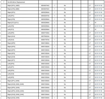

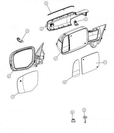

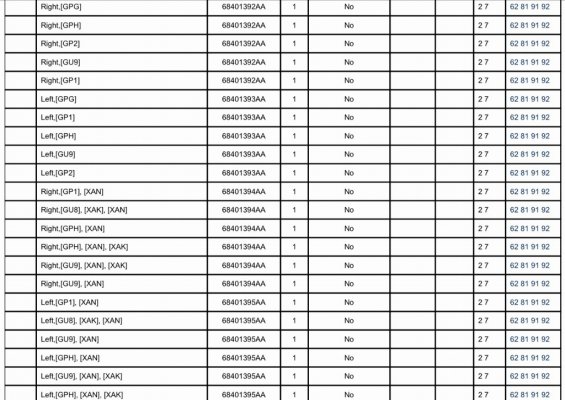

Here’s the glass for 2019 tow mirrors with blind spot (5th gen and HD)- driver side 68401395AA, passenger side 68401394AA. From the sales code GU9, it seems they are auto dim, but I’m not sure. From other pics of how the 4th gen glass is mounted, these look a little different, but it does look exactly the same as the trail ridge glass mount. I don’t know if the plastic on the back of the glass can be swapped. I’ll leave these pics to see what you guys think. XrxECt9.jpg HmJGePf.jpg j7uCgx1.jpg pkILz78.jpg ULJryON.jpg

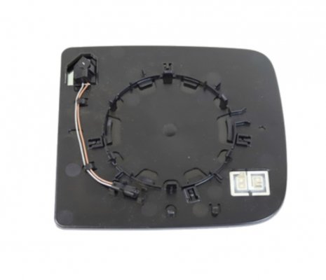

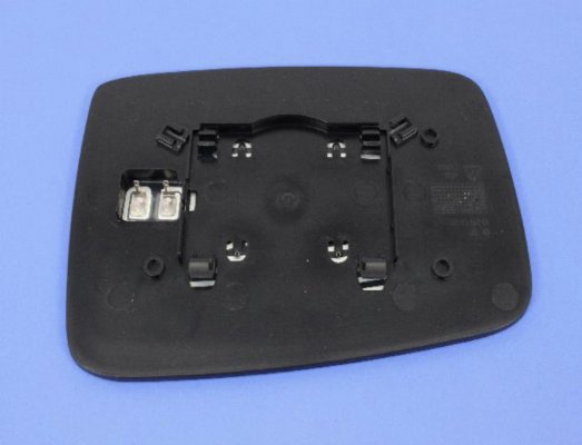

I ordered that mirror glass, they are supposed to get here Wednesday, I think the mounting looks the same. Here is a pic of the '18 and older glass

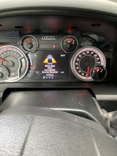

Mine did not like not having the led indicators in the mirrors hooked up, I got the open circuit codes in the door modules and the blind spot monitoring was not working, I got this message on the evic
But I don't think I had any mismatch codes in the BCM or sensors

You’ll also notice there is a distinction in the color orange and the EVIC message between whether the sensor is at fault or the indicators are at fault.
