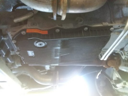

Like said above, headers are out, but you don't need them anyway for the pentastar. The OEM exhaust wouldn't be difficult for someone with the skills and resources. Sorry about the glare in this pic, but here's the underside of my (former) 2017 Ram 1500 quad cab 4x4 w/pentastar).
These have kind of an old school setup with equal sized flanged downpipes on either side of the trans. You could have a real dual system made up easily. The catalytic converters and up/down stream O2 sensors are way up out of the way by the engine.
