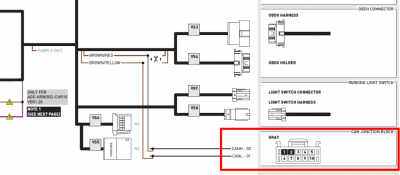

Installing the FLRSCH10 unit right now. For the 2018, the harness needs to be opened up and 2 wires need to be run to the "CAN JUNCTION BLOCK" (gray). I have no clue where this socket or plug is. The online guide is a mess to be honest. Do you have an idea?

I think I found this plug, hiding to the side all wrapped up in foamy tape, unused.
Questions is, is the posted plug in the diagram the top-view or the back-view of the plug. Yet another nice guessing game.
Man their manual sucks ass! And why don't they have a kit for 2018s with a proper plug in place? Half-assed ********!

Tried the back-view connection, was able to code the module and flash the key data on the commuter. Reconnected to the truck, still not working. Now the LEDs won't come on again even though I didn't change the wiring.
Reset the module, now it's not going into coding mode again.
What a finicky ************* this is.

I made it work. There must be a defective wire in the harness. If I bend it one way, it works, if I bend it the other direction it doesn't. Used a zip-tie to keep it bent in the working direction until I have replacement.
Wasted several hours with this ********. Would not buy again.
