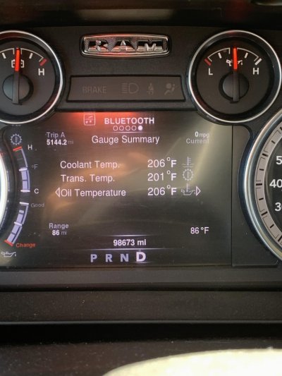

my 6 speed auto is overheating as of recently, only when it’s idling in park, neutral or drive. i’ve noticed that once the trans hits 180 or so you can put it in park and then drop it back into drive and it’ll cool down around 10 degrees, i don’t have a trans thermo on my truck. hottest it’s gotten is 204, and the trans started to shift incredibly slow and smash into gear. when it’s at highway speed it runs from 140-160 usually without issue. is this normal?
this was taken a few weeks ago on 8/8, i have since hit 100K.

How long of a drive posted that engine oil temp? Is the engine oil also getting hot? I see the coolant was 206, does it pretty much stay right on 203/4 while on freeway?
That drive was around 40-50 minutes, and yes, it stays at 201-206 at most on the freeway. Idling the engine can rise up to 220, same with the oil. The trans (as previously mentioned) stays at 140-160 when doing highway speed and can rise up to 180-190 idling, but once speeding up from a stop all 3 drop to normal, takes a bit for the trans but it gets down there
