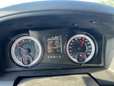

Message @caulk04 and see if he has any tstat deletes left or do what @Wild one and I did and just pull the heater off and plug the holes in the heater assembly. Look at the temp in my picture for the trans. That’s with the heater assembly deleted. https://www.ramforum.com/threads/8hp70-heater-bypass.172998/
