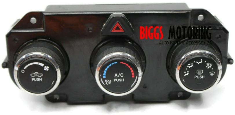

Post an image of your HVAC Controls
if you have the one with buttons that read PUSH on the knobs, there is a way to test your 4 actuators
