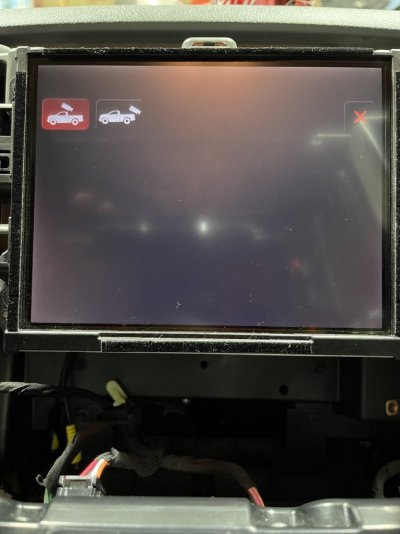

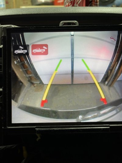

So I had messed around with the BCM settings before I changed out the original radio with the UAQ. I never had the icon to view the tailgate camera on command but I did have the icon to view the cargo camera. I don't have the cargo camera installed yet, so I would just get a blank screen but that screen would also bring up the icons so I could switch back and forth between viewing the cargo camera or the tailgate camera. These are the screens I got with the original radio:
I can confirm that I could pull up both of these screens while driving, though the tailgate camera would go blank once I got over ~10mph.
These are the system information numbers for the original radio:
After I put the UAQ in, I no longer get the icons to switch between the tailgate and cargo cameras when either the cargo camera is pulled up by tapping on the icon or the tailgate camera is pulled up by shifting in reverse. Functionally this means I have no way of accessing the cargo camera when I'm in reverse, so I won't be able to use it to back up to a fifth wheel and I can no longer look at my tailgate camera when driving slowly in drive.
View attachment 485686View attachment 485685
View attachment 485687View attachment 485688
View attachment 485689View attachment 485690
curious.. did you pull fuse/ disconnect battery before swap?
