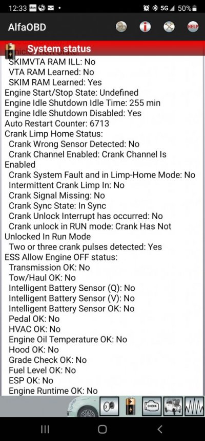

I would very much appreciate someone comparing a few parameters from a 2014 Hemi.
Under "read system status" of the "engine" with the truck running can you compare what I have to what you have please??
Vehicle Theft State:
SKIMVTA RAM ILL: No
VTA RAM LRND: No
SKIM RAM LRND: Yes
Engine Start/Stop State: Undefined
Engine Idle Shutdown Idle Time: 255 min
Engine Idle Shutdown Disabled: Yes
Auto Restart Counter: 6609
Crank Limp Home Status:
Crank Wrong Sensor Detected: No
Crank Channel Enabled: Crank Channel Is Not Enabled
Crank System Fault and in Limp-Home Mode: No
Intermittent Crank Limp In: No
Crank Signal Missing: No
Crank Sync State: Out of Sync
Crank Unlock Interrupt has Occurred: No
Crank unlock in RUN mode: Crank Has Not Unlocked In Run Mode
Two or three crank pulses detected: No

Looks like you need crank channel enabled
Hope this helps.

That is GREAT, thanks for this. I don't have the 2-3 crank pulsed detected for some reason so that gives me a starting point.
