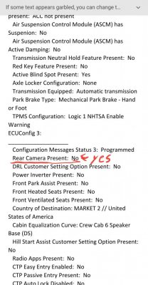

Hello All,
I've been reading through threads but I haven't found a solution. I have a 2016 RAM 2500. I purchased the rearview camera and UAQ unit from Infotainment. Everything is working except for one thing. I did not buy their programmer because I purchased an Alfaobd and OBDLink MX+.
I tried programming the rear view camera options but instead of it changing the settings, it appears to be adding settings below.
Any thoughts?
Update: I learned something new with AlfaOBD. When you make a change, it keeps adding to the file LOG. You have to delete the log and then pull log to not have an appended file.
Tested the rear camera this morning, still no option and no switch over when in reverse.
Solved:
So after 12 hours it just started working. I guess it just took a while for the body controller to activate.

You are NOT kidding. I'm a computer engineer and I was banging my head on the dashboard. But it does make me really curious how often the body computer talks to the radio head unit. It apparently doesn't that often.
