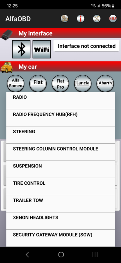

I see steering and the control module one, I pick the '12 option and it will not connect to the module. '12s are fun they're a little different than 09-11 and yet different from 13+

'12 are special Alfa lets me try to connect and backup the body computer and apparently change settings.. and restore the backup... but I don't have a BCM ;P

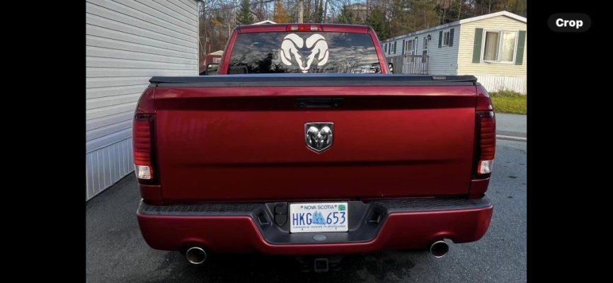

cant really there factory sport tails.just had my buddy put a remote truck starter on so he said them tales being break an turn on the same wire the resistor will prob get to hot an burn up.i was like ffs not cool.so might take my after market led tails an look at how there wired up does that make sense lol
So you've tried one or the other of the LED settings in the CGM for the 2011?
Edit: nevermind, read your other post above and see you did.
