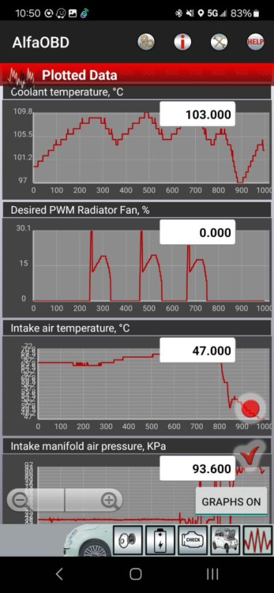

Well that's no fun, for years I was told that needed Dealer programing. I have a BullyDog GT which does most of the other features people seem to want like the fogs on with high beams, seat belt chime, etc
The one thing AlfaOBD can't do is modify the PCM. It can run lots of tests on the ECM though and adjust many settings on the BCM. It's a very useful tool. You can however read/graph data from the PCM, I've recently been using it to see how things work and if certain modifications/maintenance have a measurable effect.
