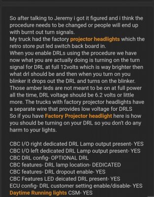

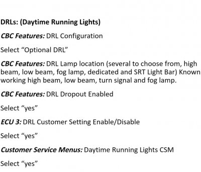

Anyone got a write up on how to do DRLs? And where to find the PIN

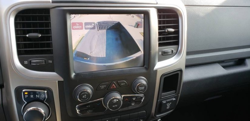

Cargo cam enabled!....now, just gotta get a new brake light with camera. Projects, projects, projects...

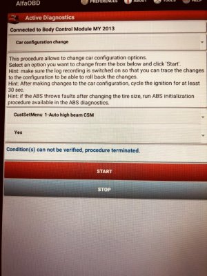

Alfa was telling me that it could not make the changes, turned the key off for a few minutes and magically....it appeared. 2013 Power Wagons are weird....
Its in the very first post under known working...also another post about using your turn signals as DRLs...I have my foglights set up.

Yes the OEM cargo cam third brake lights are definitely expensive new and they are hard to find used. STecoD and I got lucky and got a tip on a couple of used ones for about $100 less than a new one so that helped a little. I Installed the cargo cam harness from deer guy at M2mods and it works great.I just tackled the cargo camera. It’s a fairly expensive upgrade unless you can find a deal on the brake light. I thought I did, but when I got the brake light it didn’t have the camera in it. Not that big of deal, I’ll just pick up an used oem tailgate camera on the cheap. Camera showed up today and didn’t really fit right, but by removing the mounting tabs I got it in the brake light. Put the brake light back in and fired up the truck and the image was upside down. I was able to track down the right part number for the camera and it’s a little over $200 for a new one. Some lessons are learned the hard way.
