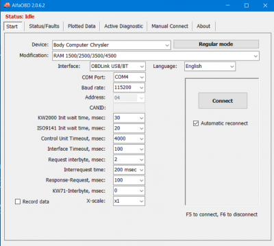

I have a 2017, and I can't connect to the mxbluetooth. Also I don't have any of what you show on the first screen. Mine says 2013-2017 Powernet. I have it set to body computer, and have tried both coms listed in the device manager. Keeps telling me to check the baud rate for Elm7? Also in advanced mode, what do I use? I have 20 different listings for Bosh, and several other makes. Alfa build 2.065 Windows 7
That is odd. If you have a OBDLink MX, there is no reason I can think of that it would be telling you to check the baud rate for the ELM7??
I don't see a listing of what you're referring to there either. When I have mine connect to the body computer and look in advanced (which I never do, regular mode always) I show the attached image. Can you post some screen shots?

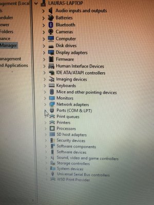

Hi guys. My name is David and I'm from Germany. I apologize for my english, that's why I use Google Translator. I do not drive a ram, but a challenger. Have read everything about Alfaobd and the possibilities to make changes. Unfortunately I do not get my Drl activated on the Challenger. I also have an OBD LINK MX. My question to you, if someone can show his Bt_debug.log
My logfile from Dodge is always
build.prop Permisson denied
what is up with you?
019/02/15 14:46:00.410: ConnectThread createInsecureRfcommSocketToServiceRecord socket created 2019/02/15 14:46:03.428: ConnectThread socket connected 2019/02/15 14:46:03.469: ConnectedThread open stream 2019/02/15 14:46:04.471: ConnectedThread send ATZ 2019/02/15 14:46:04.658: Bytes read = ATZ 2019/02/15 14:46:05.308: Bytes read = 2019/02/15 14:46:05.326: Bytes read = ELM327 v1.3a > 2019/02/15 14:46:05.326: ConnectedThread run: connection verified 2019/02/15 14:46:05.342: BT Connected 2019/02/15 14:46:17.894: Read manufacturer error: /system/build.prop (Permission denied) 2019/02/15 14:47:17.106: Serial USB closed 2019/02/15 14:47:17.106: Serial port closed 2019/02/15 14:47:24.367: Read manufacturer error: /system/build.prop (Permission denied) 2019/02/15
14:51:42.588: Serial USB closed 2019/02/15 14:51:42.589: Serial port closed
If you were using a Windows PC , then I believe you may have to change the com port. Hopefully someone else that uses a PC will confirm.

use Android. Connection to the body computer is established. The reversing camera, for example, I could turn on. looks to me as if not a full access to body computer. That's why I want to see what is in your Bt_debug.log
M² Mods.
I know with mine on the pc I went into device manager and went to com and clicked the + to open it and looked to see what com the Bluetooth was useing then set that in the program and worked

north central wv
2017 Sport Night
Thanks for that screenshot! Somehow mine was set to Elm327 rather than OBDLink. Working now, and again, thank you.
