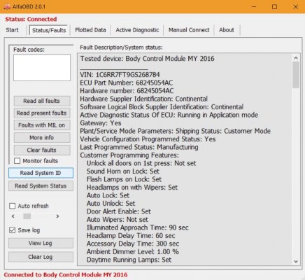

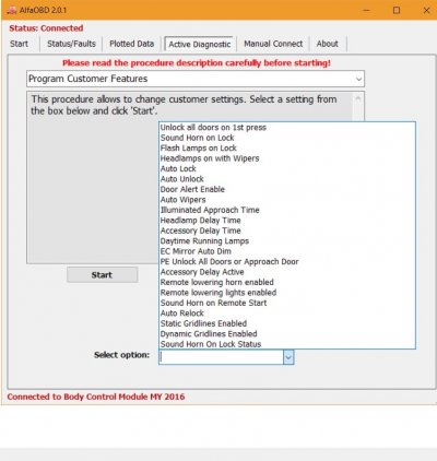

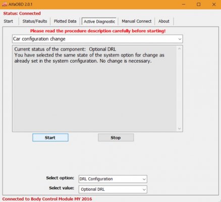

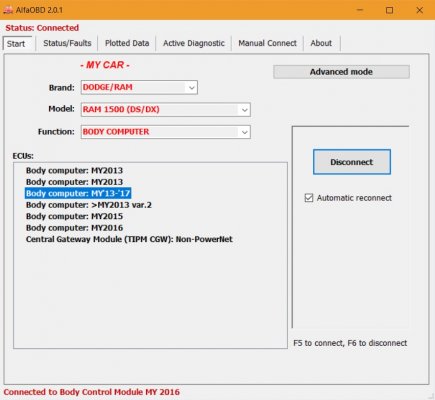

I finally got my TPMS sorted out. I had ended up buying AlfaOBD, OBDLink MX+, an Android tablet to run the sw on, and found a dealer who ONLY charged $20 for the 4 digit pin.
I used this thread for lots of info and a link to a google drive for some step by step info.
